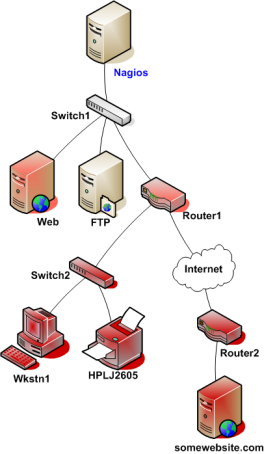

Take a look at the simple network diagram below. For this example, lets assume you're monitoring all the hosts (server, routers, switches, etc) that are pictured. Nagios is installed and running on the Nagios host.
Defining Parent/Child Relationships
In order for Nagios to be able to distinguish between DOWN and UNREACHABLE states for the hosts that are being monitored, you'll need to tell Nagios how those hosts are connected to each other - from the standpoint of the Nagios daemon. To do this, trace the path that a data packet would take from the Nagios daemon to each individual host. Each switch, router, and server the packet encounters or passes through is considered a "hop" and will require that you define a parent/child host relationship in Nagios. Here's what the host parent/child relationships look like from the viewpoint of Nagios:
Now that you know what the parent/child relationships look like for hosts that are being monitored, how do you configure Nagios to reflect them? The parents directive in your host definitions allows you to do this. Here's what the (abbreviated) host definitions with parent/child relationships would look like for this example:

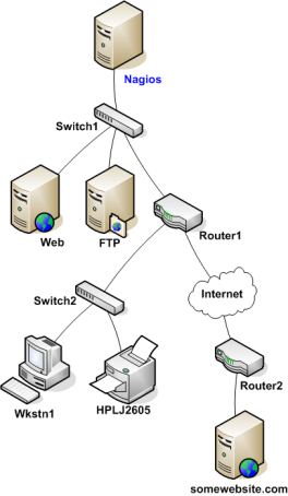

Now that you're configured Nagios with the proper parent/child relationships for your hosts, let's see what happen when problems arise. Assume that two hosts - Web and Router1 - go offline...
When hosts change state (i.e. from UP to DOWN), the host reachability logic in Nagios kicks in. The reachability logic will initiate parallel checks of the parents and children of whatever hosts change state. This allows Nagios to quickly determine the current status of your network infrastructure when changes occur.
In this example, Nagios will determine that Web and Router1 are both in DOWN states because the "path" to those hosts is not being blocked.
Nagios will determine that all the hosts "beneath" Router1 are all in an UNREACHABLE state because Nagios can't reach them. Router1 is DOWN and is blocking the path to those other hosts. Those hosts might be running fine, or they might be offline - Nagios doesn't know because it can't reach them. Hence Nagios considers them to be UNREACHABLE instead of DOWN.
