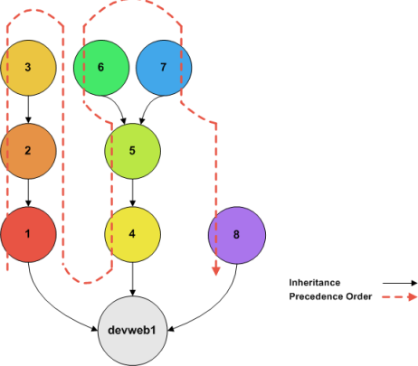

Precedence With Multiple Inheritance Sources
When you use multiple inheritance sources, it is important to know how Nagios handles variables that are defined in multiple sources. In these cases Nagios will use the variable/value from the first source that is specified in the use directive. Since inheritance sources can themselves inherit variables/values from one or more other sources, it can get tricky to figure out what variable/value pairs take precedence.
Consider the following host definition that references three templates:
# Development web server
use 1, 4, 8
host_name devweb1
If some of those referenced templates themselves inherit variables/values from one or more other templates, the precendence rules are shown to the right. Testing, trial, and error will help you better understand exactly how things work in complex inheritance situations like this. :-) |
