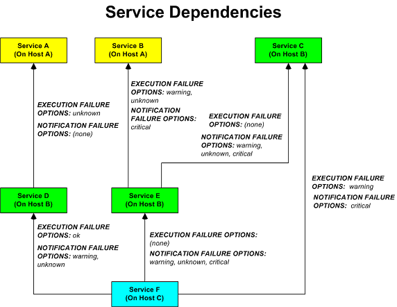

The image below shows an example logical layout of service notification and execution dependencies. Different services are dependent on other services for notifications and check execution.
In this example, the dependency definitions for Service F on Host C would be defined as follows:

The other dependency definitions shown in the image above would be defined as follows:

In the example above, Service E would have failed execution dependencies if Service B is in a WARNING or UNKNOWN state. If this was the case, the service check would not be performed and the check would be scheduled for (potential) execution at a later time.

In the example above, Service F would have failed notification dependencies if Service C is in a CRITICAL state, and/or Service D is in a WARNING or UNKNOWN state, and/or if Service E is in a WARNING, UNKNOWN, or CRITICAL state. If this were the case, notifications for the service would not be sent out.

As mentioned before, service dependencies are not inherited by default. In the example above you can see that Service F is dependent on Service E. However, it does not automatically inherit Service E's dependencies on Service B and Service C. In order to make Service F dependent on Service C we had to add another service dependency definition. There is no dependency definition for Service B, so Service F is not dependent on Service B.

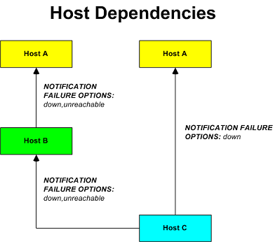

Example Host Dependencies
The image below shows an example of the logical layout of host notification dependencies. Different hosts are dependent on other hosts for notifications.
In the example above, the dependency definitions for Host C would be defined as follows:

As with service dependencies, host dependencies are not inherited. In the example image you can see that Host C does not inherit the host dependencies of Host B. In order for Host C to be dependent on Host A, a new host dependency definition must be defined.
Host notification dependencies work in a similiar manner to service notification dependencies. If all of the notification dependency tests for the host pass, Nagios will send notifications out for the host as it normally would. If even just one of the notification dependencies for a host fails, Nagios will temporarily repress notifications for that (dependent) host. At some point in the future the notification dependency tests for the host may all pass. If this happens, Nagios will start sending out notifications again as it normally would for the host. More information on the notification logic can be found here.
