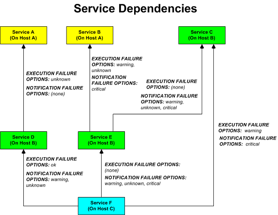

The image below shows an example logical layout of service notification and execution dependencies. Different services are dependent on other services for notifications and check execution.
In this example, the dependency definitions for Service F on Host C would be defined as follows:
define servicedependency {
host_name Host B
service_description Service D
dependent_host_name Host C
dependent_service_description Service F
execution_failure_criteria o
notification_failure_criteria w,u
host_name Host B
service_description Service E
execution_failure_criteria n
notification_failure_criteria w,u,c
host_name Host B
service_description Service C
execution_failure_criteria w
notification_failure_criteria c
The other dependency definitions shown in the image above would be defined as follows:
host_name Host A
service_description Service A
dependent_host_name Host B
dependent_service_description Service D
execution_failure_criteria u
notification_failure_criteria n
host_name Host A
service_description Service B
dependent_service_description Service E
execution_failure_criteria w,u
host_name Host B
Before Nagios executes a service check or sends notifications out for a service, it will check to see if the service has any dependencies. If it doesn't have any dependencies, the check is executed or the notification is sent out as it normally would be. If the service does have one or more dependencies, Nagios Core will check each dependency entry as follows:
This cycle continues until either all dependencies for the service have been checked or until one dependency check fails.
Note: *One important thing to note is that by default, Nagios Core will use the most current hard state of the service(s) that is/are being depended upon when it does the dependeny checks. If you want Nagios Core to use the most current state of the services (regardless of whether its a soft or hard state), enable the soft_state_dependencies option.
Execution dependencies are used to restrict when active checks of a service can be performed. Passive checks are not restricted by execution dependencies.
If all of the execution dependency tests for the service passed, Nagios Core will execute the check of the service as it normally would. If even just one of the execution dependencies for a service fails, Nagios Core will temporarily prevent the execution of checks for that (dependent) service. At some point in the future the execution dependency tests for the service may all pass. If this happens, Nagios Core will start checking the service again as it normally would. More information on the check scheduling logic can be found here.
In the example above, Service E would have failed execution dependencies if Service B is in a WARNING or UNKNOWN state. If this was the case, the service check would not be performed and the check would be scheduled for (potential) execution at a later time.
If all of the notification dependency tests for the service passed, Nagios Core will send notifications out for the service as it normally would. If even just one of the notification dependencies for a service fails, Nagios Core will temporarily repress notifications for that (dependent) service. At some point in the future the notification dependency tests for the service may all pass. If this happens, Nagios Core will start sending out notifications again as it normally would for the service. More information on the notification logic can be found here.
In the example above, Service F would have failed notification dependencies if Service C is in a CRITICAL state, and/or Service D is in a WARNING or UNKNOWN state, and/or if Service E is in a WARNING, UNKNOWN, or CRITICAL state. If this were the case, notifications for the service would not be sent out.
As mentioned before, service dependencies are not inherited by default. In the example above you can see that Service F is dependent on Service E. However, it does not automatically inherit Service E's dependencies on Service B and Service C. In order to make Service F dependent on Service C we had to add another service dependency definition. There is no dependency definition for Service B, so Service F is not dependent on Service B.

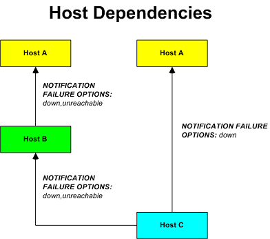

As you'd probably expect, host dependencies work in a similiar fashion to service dependencies. The difference is that they're for hosts, not services.
Tip: Do not confuse host dependencies with parent/child host relationships. You should be using parent/child host relationships (defined with the parents directive in host definitions) for most cases, rather than host dependencies. A description of how parent/child host relationships work can be found in the documentation on network reachability.
Here are the basics about host dependencies:
The image below shows an example of the logical layout of host notification dependencies. Different hosts are dependent on other hosts for notifications.
In the example above, the dependency definitions for Host C would be defined as follows:
define hostdependency {
host_name Host A
notification_failure_criteria d
host_name Host B
notification_failure_criteria d,u
As with service dependencies, host dependencies are not inherited. In the example image you can see that Host C does not inherit the host dependencies of Host B. In order for Host C to be dependent on Host A, a new host dependency definition must be defined.
Host notification dependencies work in a similiar manner to service notification dependencies. If all of the notification dependency tests for the host pass, Nagios Core will send notifications out for the host as it normally would. If even just one of the notification dependencies for a host fails, Nagios Core will temporarily repress notifications for that (dependent) host. At some point in the future the notification dependency tests for the host may all pass. If this happens, Nagios Core will start sending out notifications again as it normally would for the host. More information on the notification logic can be found here.
